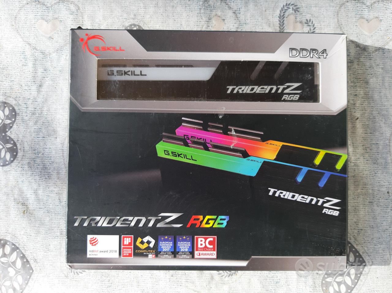

#55 · (Edited)
hello, it's still me ... I wanted to ask about another product. I found it in very good condition gskill trident rgb (I put links). They are 32gb (2Ă—16) 3600mhz cl17-19-19-19... do you think they are with Samsung b-die chip ? I did some research on the product code online and they say they are b-die...confirmed?
@bhav can you help me again please?
#56 ·
I know its a different country, but even if it is B die, those are still only ÂŁ151 brand new in UK:
And actually cheaper on Amazon, if you have prime you should get free imports:
The timings don't look like B die to me.
Reactions: mussihd99
