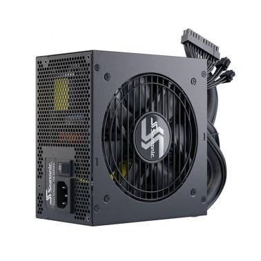

I have 3080 suprim x 10GB i was have 650 seasonic focus gx 80 gold he normally turn of on gpu OC i change for 1300 seasonic prime 100MHz more OC on GPU.
Reactions: Mick5008

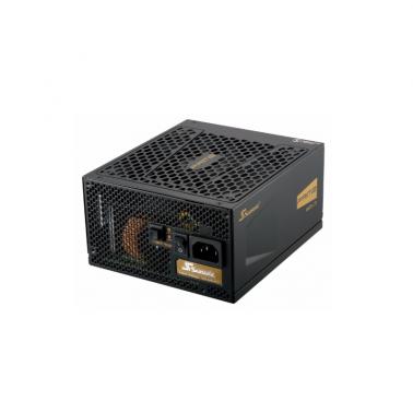

Why you search for 850W it is too expensive for you buy 1300W Seasonic PRIME 1300W 80+ Gold .From my siede its 3 wery good thing about this power supply 13900K can be OC, any gpu you buy you can use.12 years warranity.
Reactions: Mick5008
