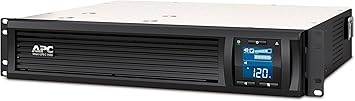

#5 ·
Anyone have any words of advice?
Search local warehouses for used APC products.
Add the cost of fresh batteries in the bill, and you will be good to go.
Rack-mount UPS they are made at 1500 to 3000 Watt.
If you find a solution at less than 2000$ it would be a miracle.

#15 ·
Pure Sine Wave for $519.00
Yes this is the price point of such solutions, I paid 750 (Euro dollars) :)
But I got with it, also the APC software for five nobs control over LAN.
The software pack this is also an important part of a good deal.
